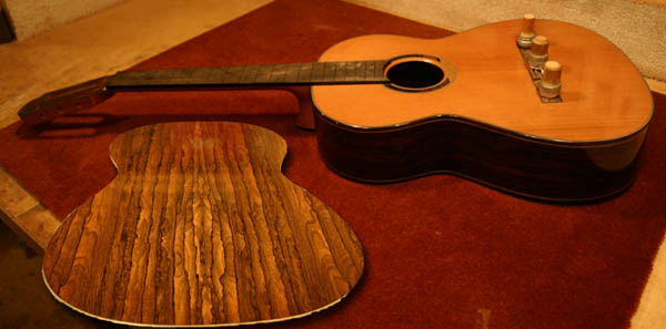

I feel your pain. I just finished my first classical and 13-fret 00. I was able to quickly judge the tone of the 00 (I am extremely pleased) but was clueless as to the "correctness" of the classical. Sergei de Jonge said it sounded like a concert classical to him. I'll bring it to a couple of players I know to get their thoughts... maybe you could do the same since I don't think there's anything remotely like a high-end classical at the GC except for the odd Jose Ramirez.
Oh, for the rest of the group here are the specs:
Redwood top (travesty!)
Ziricote back/sides
Lattice bracing pattern (blasphemy!)
Dovetail neck joint w/bolt (scandalous!)
645 mm scale length
49.6 mm nut
3.8 mm bass / 2.7 mm treble action
Cheers,
Warren

[QUOTE=Serge Poirier] Hey Warren, congrats Man, how about a pic or 2 please?[/QUOTE]
Hi Serge,
I don't have the final shots of the guitars yet: I'm giving the French polish an extra week to harden before they're buffed up. I'm not sure which shots will go into the Fretboard Journal article either but I think this composite shot of the ziricote that I whipped together is safe.
The ziricote bridge (to be oiled) is being glued on with magnets. The back has a single coat of shellac on it for demonstration purposes only.
Cheers,
Warren
